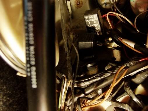

I think the problem will be either in the relay or the indicator stalk, but think the relay is much more likely for the reasons that JG says. In any event, this is the easiest/cheapest fix so is the logical starting point. I'd recommend that you replace it and either solve the problem or rule it out as an issue. The relay is located under the hood, tucked right up to the dash on the drivers side. See the picture of mine below - its the fore most relay that's all black (i.e not the rear one with white writing on). Its the bonnet ram on the left.
You may need to disconnect the electrical connector directly underneath but inside the cab. I've tried to show this in the photo below. Its the large round black "plug" on the left nearest the circular ventilation pipe.
