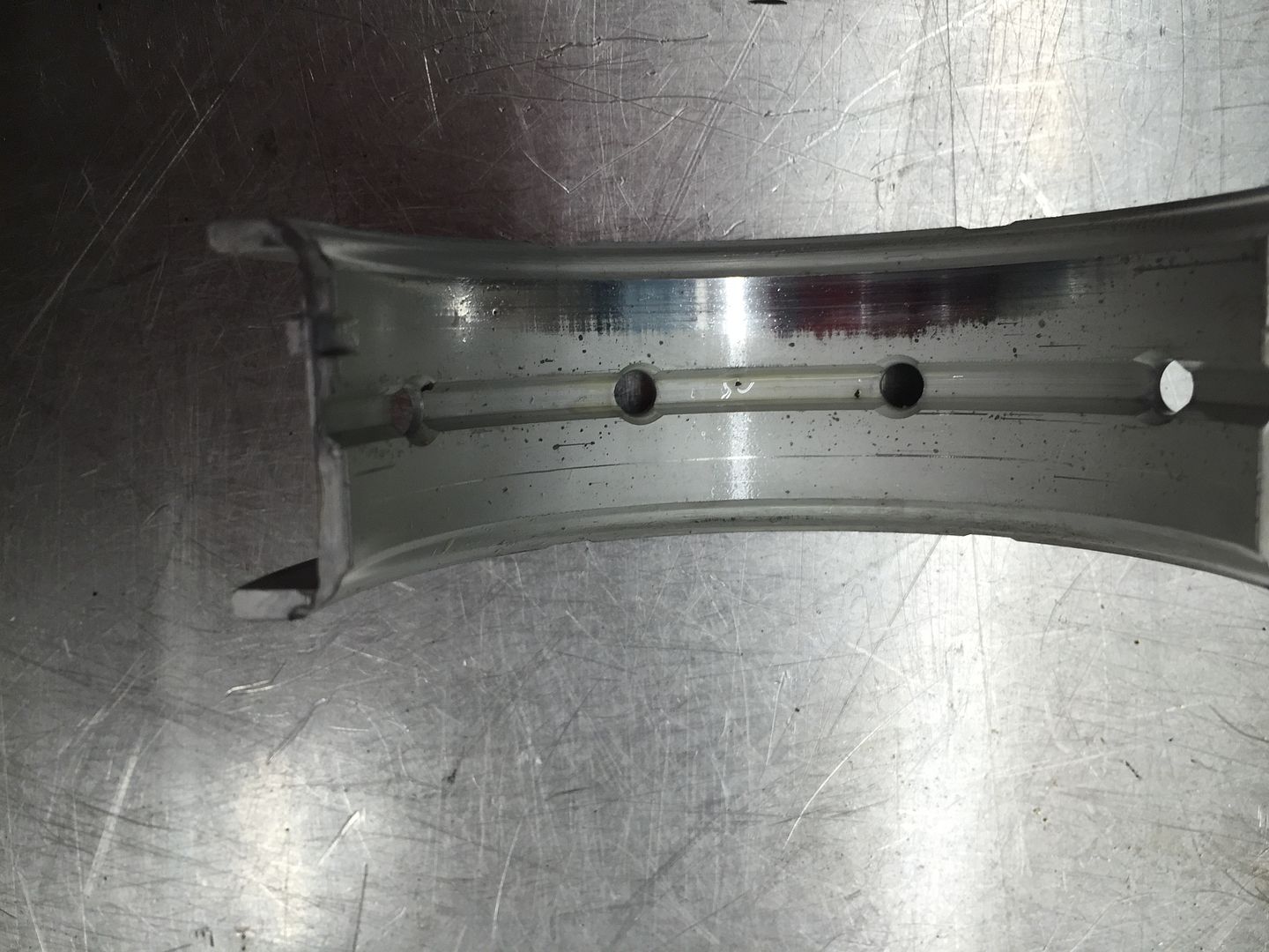

I showed the picture of you main bearing shells to someone who knows a bit about engine bearings for a second opinion, his thoughts were:
  • He's seen these washboard wear lines before, more commonly on larger engines, and usually on engines that haven't failed
  • In his experience the root cause of these wear marks has been with the machining of the bearing shell shape... possibly caused by wear in the bearing race of the fine turning head that completes the bearing machining op, leading to a very shallow (microns in depth) waviness around the bearing.
  • In his opinion the level of marking on your shells wouldn't be a durability/failure risk but may increase sensitivity low oil pressure, dirt, etc..
Overall he thought that even though the bearings look rough in the pics, in reality they are not that bad and he wouldn’t expect the driver to notice anything resulting from this...
He didn't think it looked like a 'tight' build either - I would have thought if it had been tight it would have been more noticeable in the first few minutes/hours of running, not after a 1000 miles.

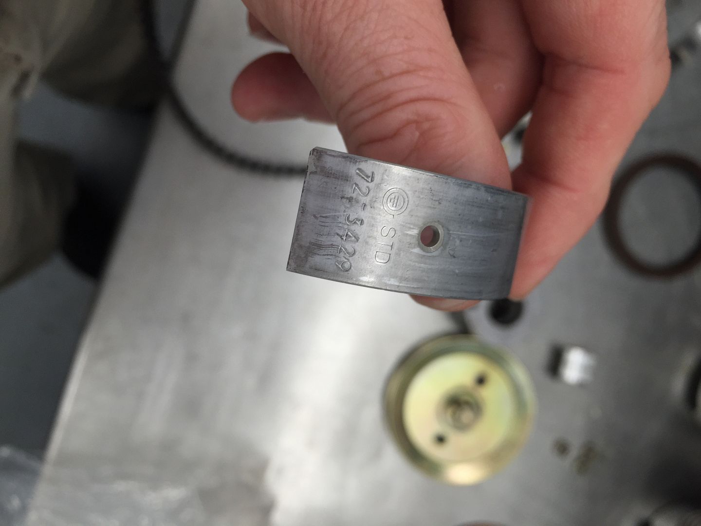

Bearings were genuine Glyco ones from Nottingham OPC, so not aftermarket not-so-good quality ones.
Big end bearings were worse than the main bearings.

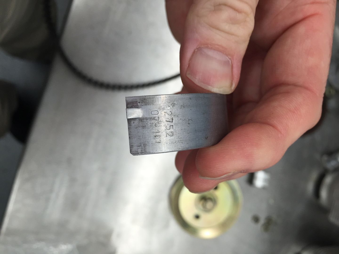

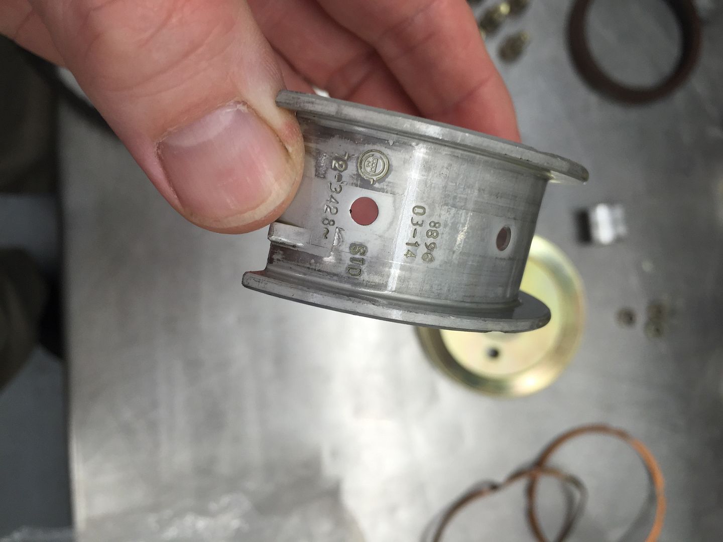

Some more pics for you:
961D722A-9AFA-4952-91ED-BF868401BBC0_zps
A4535131-114F-465F-939D-3CB4AB584FE8_zps
AD12E514-C72E-46AD-B1E8-C6993E70DFFA_zps
D6FBB0D7-CBBC-44BB-B033-36B263AE0308_zps
C59D7694-C8EA-4850-B8D7-40655E10116C_zps

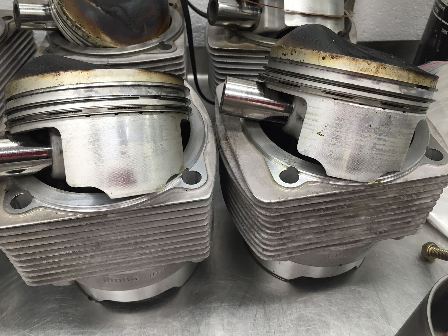

Pistons and rings are all OK:

So sh*t bearings or oil starvation?
The latter, but quite how? Stumped.
Edited by Dr Rock
Down to the build then, hope GCR stand by their reputation on this.
So how come everything was fine for 1000 miles? :unsure:
Cos it took 1k for the bearings to get like that with not enough oil. I don't know? Just spouting random sh*t.
It took < 4 miles at low speed and rpm's to do that.
:whistling:

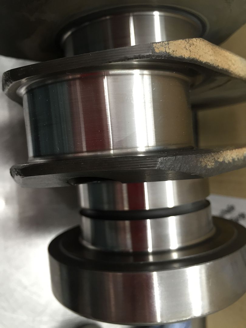

Photo update - crank and rods are back, bearings and crank are standard, not over/undersize.

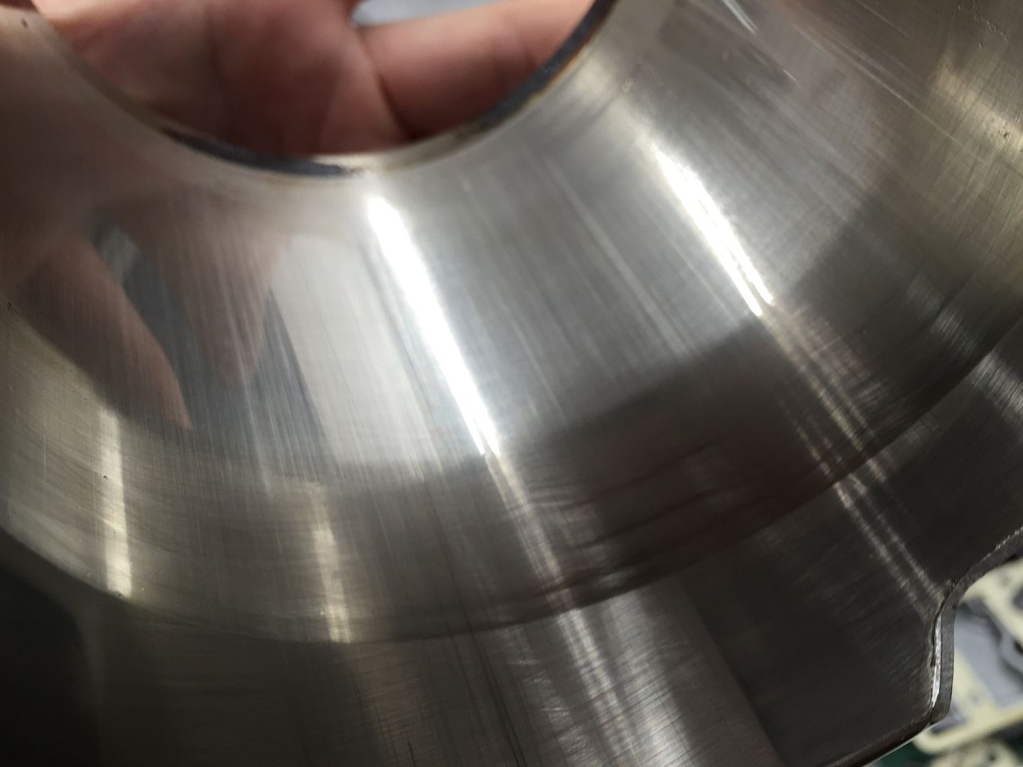

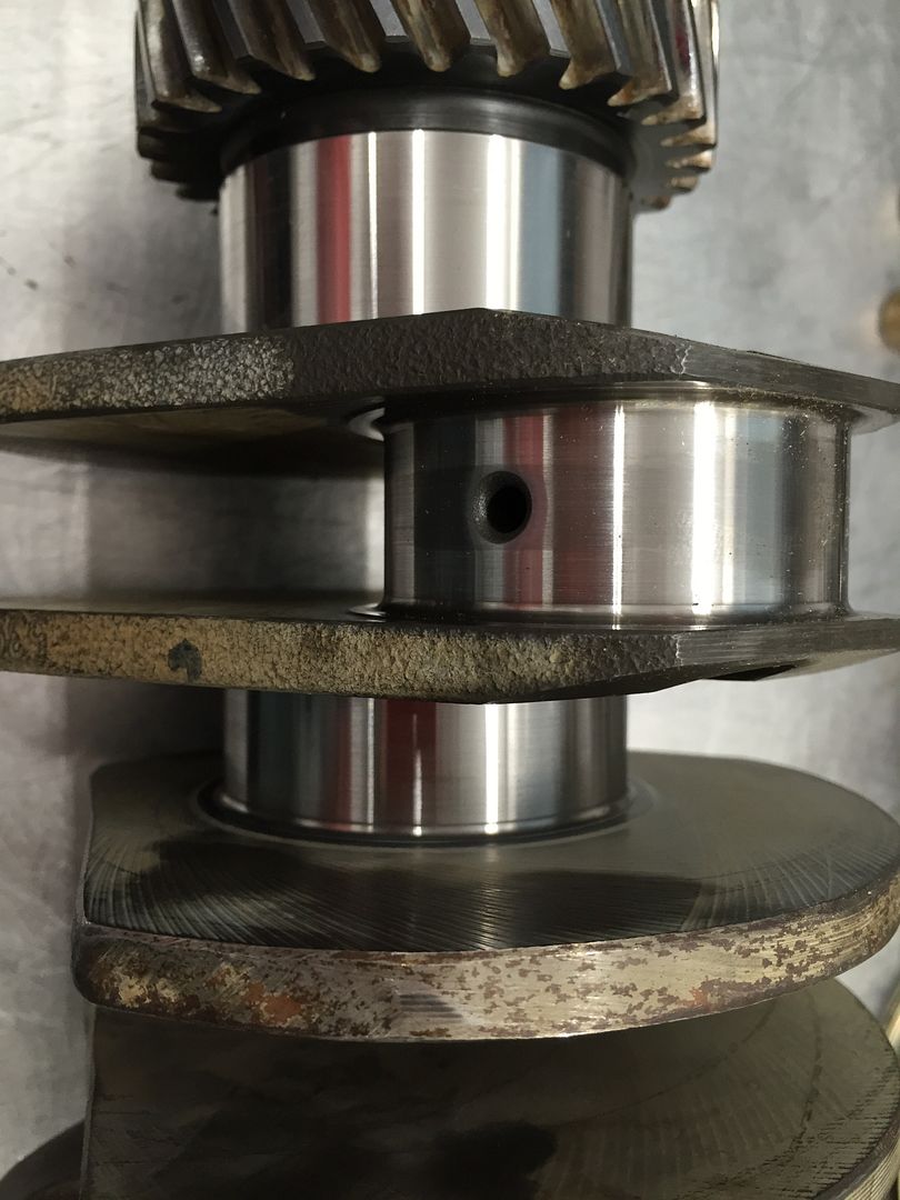

Crank all polished and yummy:
6C6909F1-B3FF-4D38-9539-FA5487B99290_zps
761F8FA7-097A-4E89-A086-B8B35351A46D_zps

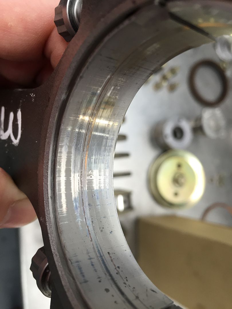

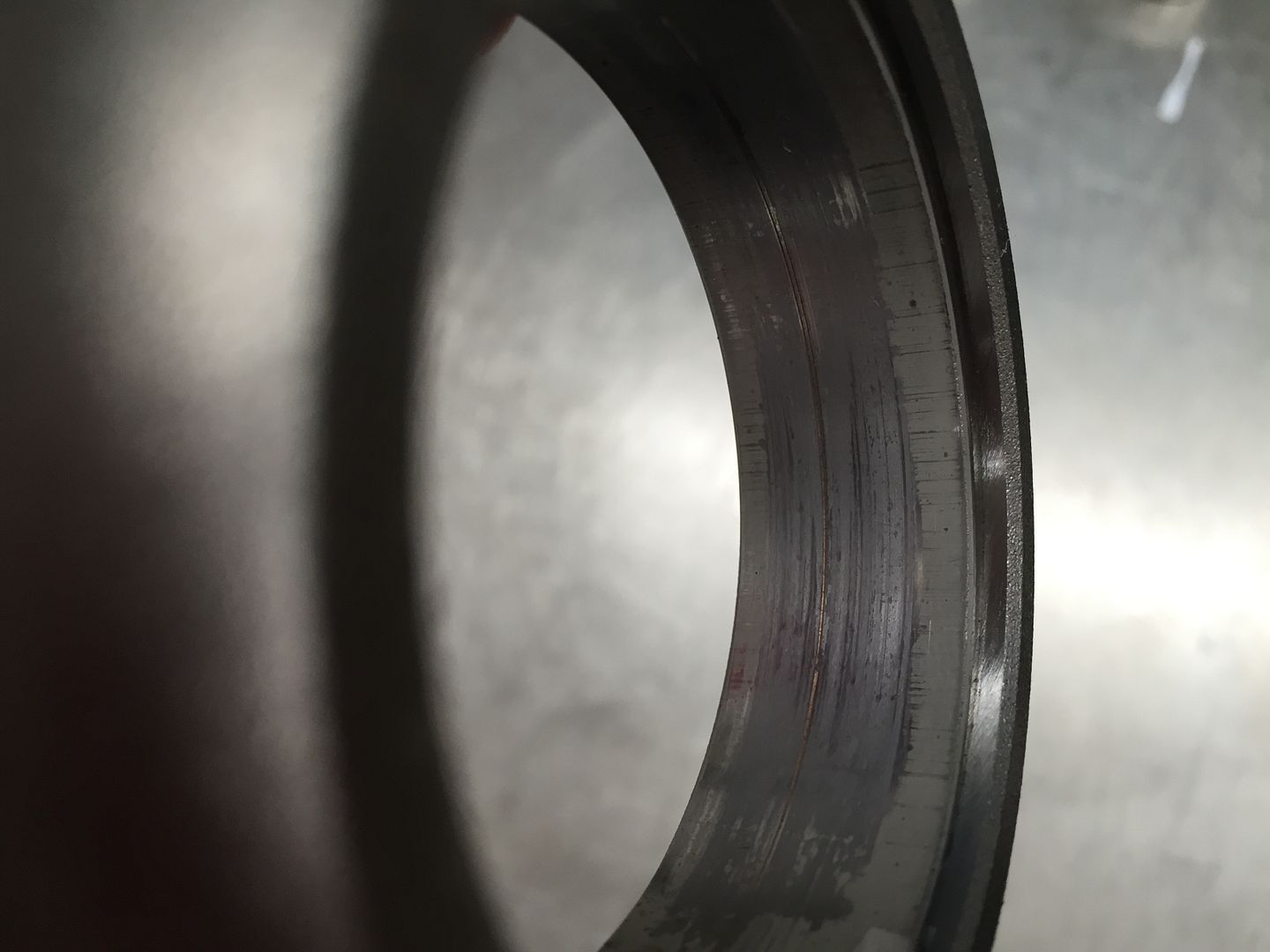

Rods are fine, just need bearings: No.6 was deemed the worst:
4E7AC9F8-6F54-449B-8C30-D8A15D814D40_zps
091DD073-824E-4618-B5CC-E27BBF400193_zps
But I reckon No.3 is worse:
6C9A223E-AF0C-4D83-85E8-F8A583A3E73D_zps
3768DE65-C215-4A72-B5A4-BE44724CCF33_zps
Barrels are lovely:
6E193373-AE62-4763-BCB2-D1FB4BD1D811_zps
