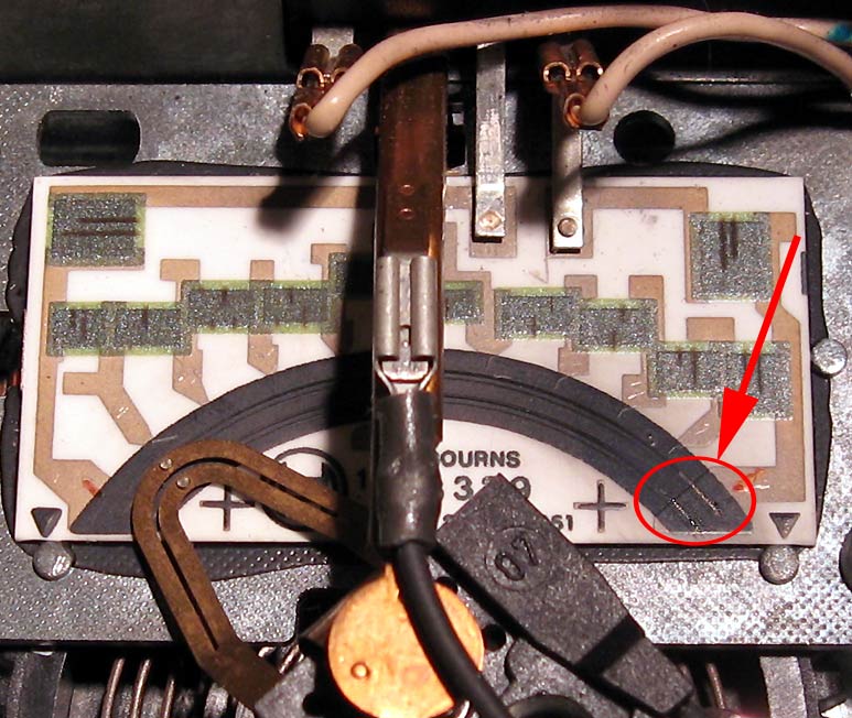

Removed the AFM last night and opened it up. I've got some pics which I will sort out soon.
Whilst there are tracks in the copper they don't look like a cause for concern - also they appear to be consistent right across the arc of the unit, i.e. wear looks consistent. I did push the wiper down on the shaft to move the contact points out on the copper track - it would only move a very slight amount, but enough I think to contact fresh copper.
Pic attached but not very good - I will take some better pics before I re-seal the lid.
Just need to find something to seal the lid with - any suggestions if my work buddies can't come up with any pukka stuff?

I had the same problem with my 3.2 carrera two years ago,
I removed the AFM, opened it up then inspected it for wear,
There didnt seem to be any wear visible to the eye,
I then gave it a good clean, mainly all the contacts, sealed it up then replaced it,
The problem of "kangarooing" had gone, :woohoo:
But after a few weeks the problem reappeared :eusa_boohoo:
So I removed it and cleaned it again, problem gone,
Then it reappeared again !!!!!
This went on for about 4 or 5 removal and replacements,
In the end I bought a second hand AFM from Porsch-apart for 50 quid.
No more problems so far. :signs118:
So if you clean it, replace it and your problem has gone it will more than likely be the AFM,but like mine it might reappear.

Really difficult to take a good picture of the wiper and copper track, but the two best ones are here, which show the tracks in the copper made over time by the contact points of the copper wiper. These photos show the wiper after I had loosene the central clamp bolt and pushed it down on the central shaft. It did not move very much at all - and there appears to be no further potential for movement. I think that the wiper points are contacting fresh coppoer, but it's a close-run point!
Longest part of the job was cleaning all of the old sealant from around the lid and the AFM to allow for a good seal with the new sealant. There is no mechanical fixing of the black plastic lid on the AFM - the sealant also acts as a securing adhesive. Only problem (so far) with the stuff I snaffled from work is that it is white.
Removal of the AFM from the car is very straightforward - I took it out with half of the airbox attached (there are four bolts that attach the airbox to the AFM which are easier to remove/replace with the whole assembly out together.
The AFM is currently sat on my desk allowing the sealant to cure and I shall re-fit this evening.
