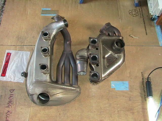

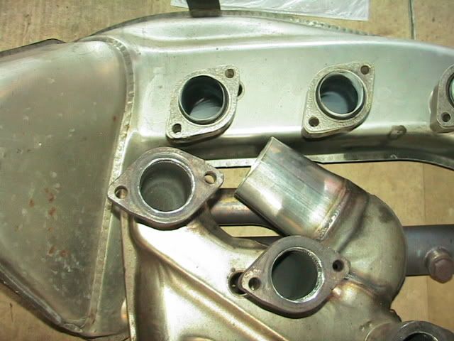

The more I think about this the more I am convinced that SSIs for 3.2s just do not make a lot of sense. I can't understand how the little pipe sticking up into the exhaust port can be anything other than a really poor idea from the point of view of flow. See this picture for example and comparison with a 993 HE where I have done a little grinding to match the exhaust port diameter.

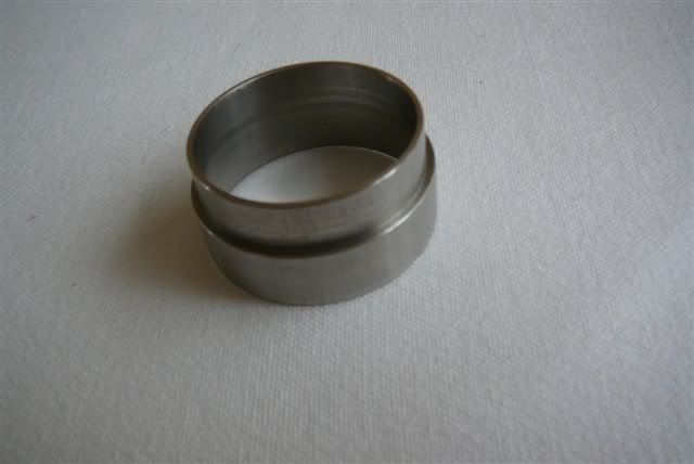

There is a gentleman in Belgium who has made some adapters to make SSIs work "properly". They are not for sale AFAIK, he just made them to solve what he thought was a crazy design. It is not easy to see but this little "turtle-neck" takes the 39mm port down to 35.5mm SSI primary.
I like the equal length element but with cams that can be fitted to a common plenum intake engine, you get only minimal exhaust pulse tuning benefits at best so why have such a bulky HE? Compare -
You really need S cams or similar to get benefit from an equal length system IMHO.
