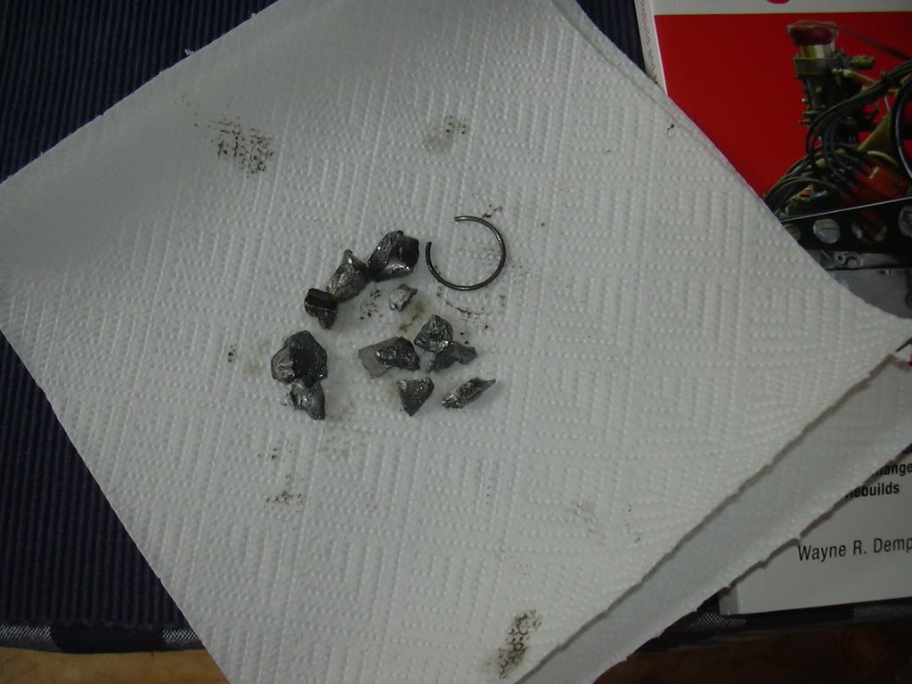

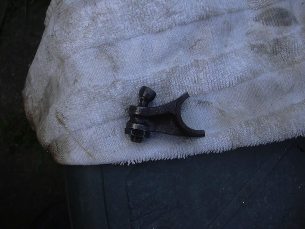

Debris I found in the sump. Is that a gudgeon pin circlip?
I also found that the throttle appeared to be stuck wide open, it snapped shut when I disconnected the linkage, the loud pedal has a socket moulded into the underside, there is a rod with a ball shaped end which locates into this socket, that is apart....not sure what is going on here, but I suspect the throttle stuck wide open and that it why I bought a car with a broken engine.
Needless to say a very careful examination of the throttle controls will be undertaken before I start the car post rebuild.

Gudgeon pin circlip indeed - and piston bits I re-con.

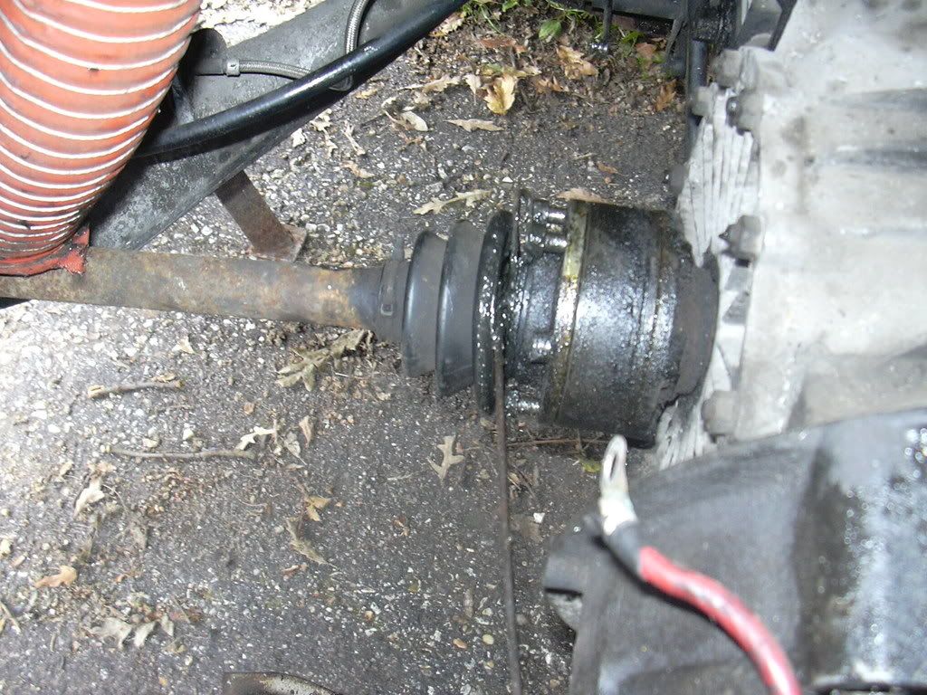

The plot thickens, it looks like the throttle linkage came apart up by the transmission, the rod dropped onto the drive shaft, the drive shaft grabbed hold of it and gave it a good yank, its wrapped right round the shaft then disappears into the engine bay.

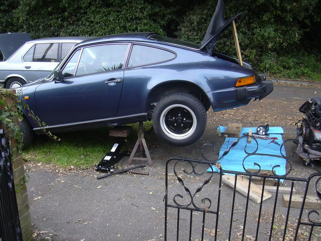

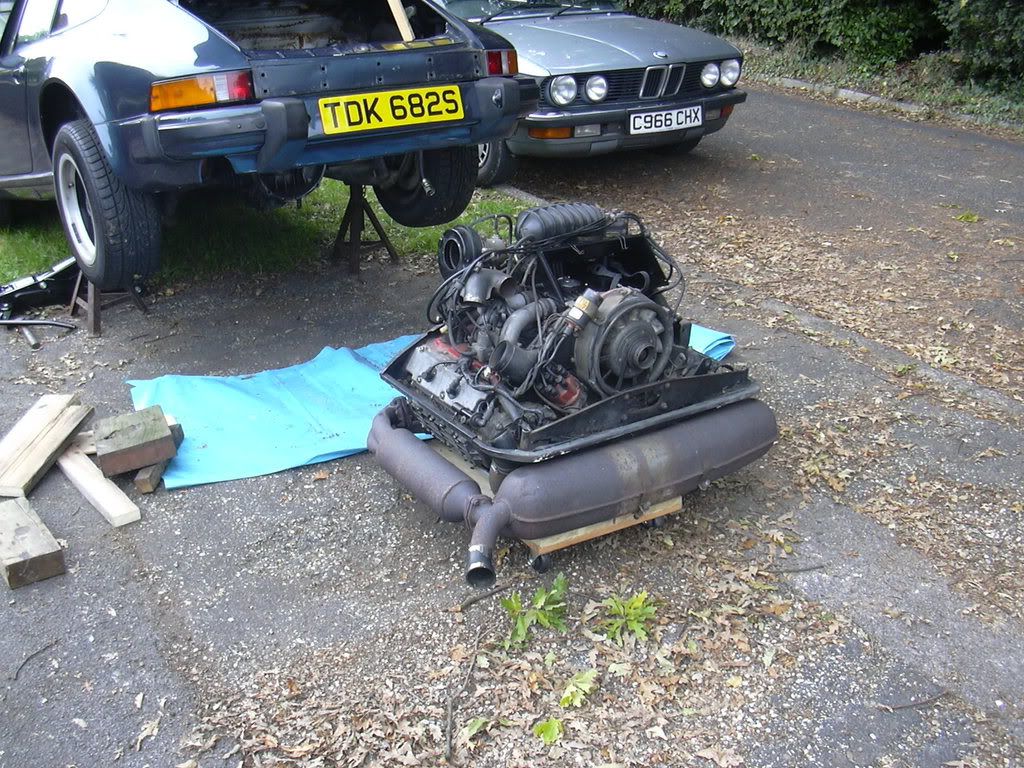

This crack of removing engines out the bottom is the easiest I have ever done by miles, just done it single handed without breaking a sweat (well almost, beads were forming).
Its on the floor
See picture of linkage rod wrapped around CV joint!!

Worst bit of being on your own is trying to drag the trolley jack out from underneath with the engine balancing on top. Especially if on an un-even surface and the tinyest bit of grit can jam the wheels. Big sheet of thin ply of MDF on the ground helps.

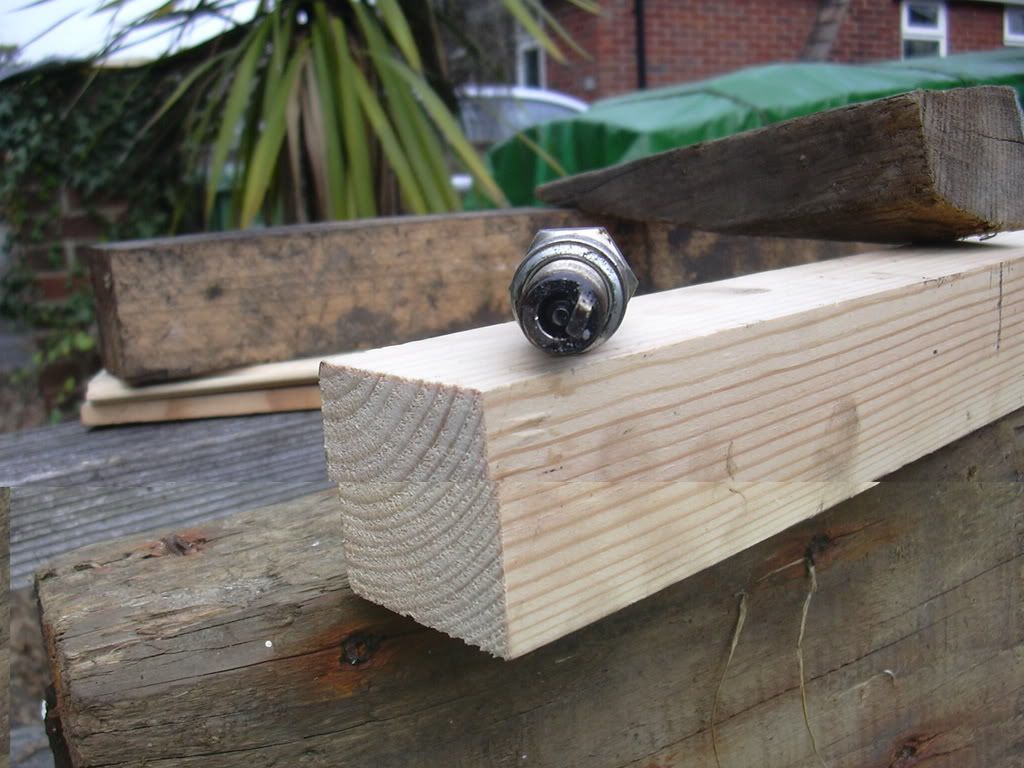

Plug came out of right rear cylinder, others look fine. Picture not very clear, but plug tip is mashed and bent, hmm.

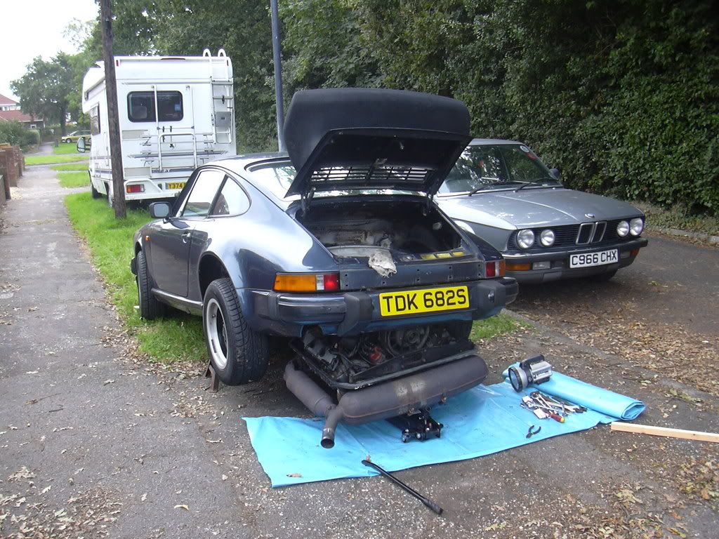

All tidied up and in for a spot of lunch!
Fast work mate and with pics too!
Pleased you bought that car now - would have taken me 6 months to get where you are already.
Enjoy the lunch
