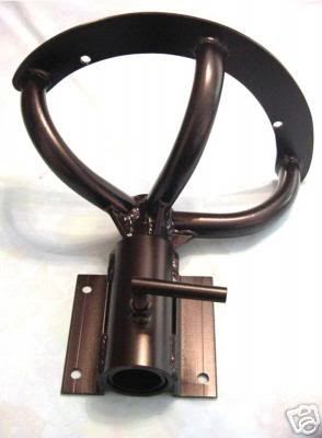

Do not use a 3 leeged stand, it is guaranteed to topple with a Porsche engine on it! I would only ever use the correct attachment, but they aren't cheap
Here you go!. Ebay is your friend. Buy one of these and a Clark engine stand from Machine Mart like this one.
It's the same basic setup as I've got and works a treat. You can move the whole lot around fairly easily and stability isn't an issue. I've had heavier than a Porsche lump on that stand without any problems.

My second 944 Turbo engine is currently sitting on the same stand as Ben, seems to work OK, though I would prefer the U shaped so I could insert a proper drain tray underneath.
I don't like those 3 wheelers much :o
Mike Bainbridge had a batch of correct engine stand attachments made. Not sure if he has sold them all or not but might be worth giving him a call

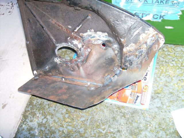

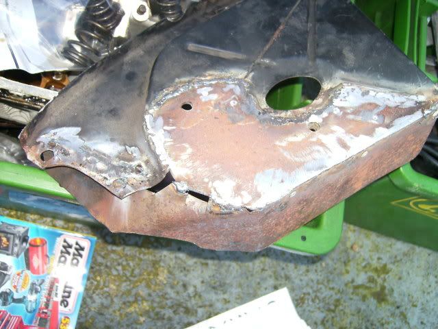

Got the welder out and had a go at the engine tin, should do the job with a bit more fettling.

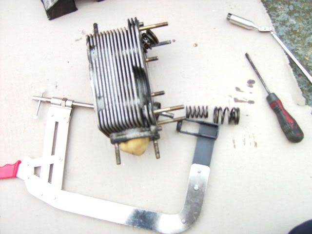

Purchased a spring compressor:

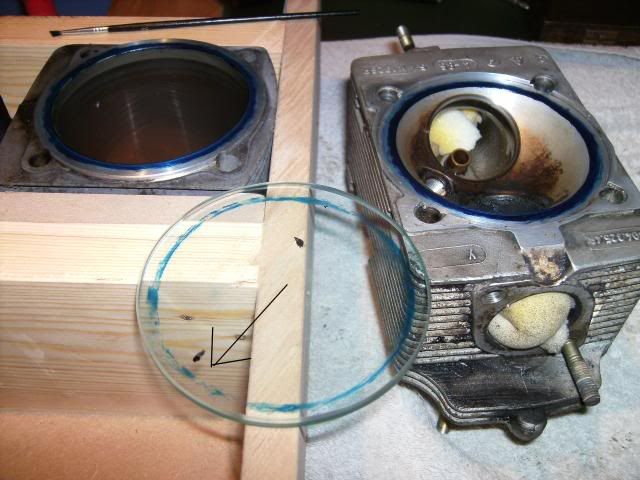

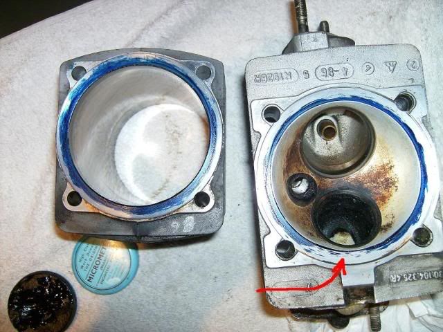

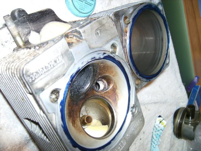

The leak/oil spatter i had was due to No 6 & No2 cylinder leaking at the head joint on the exhaust side, i suspected broken head studs but after pulling the heads every head stud is fine.

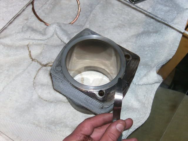

Got the engineers blue out last night and this is the result on No 6 cylinder, you can see where it was blowing.
1st. Could this be put right by lapping the heads in or is it a machining job
2nd How could this have happened if all studs where fine and tight
3rd Should i replace all the head studs with 933 studs or can i just replace the bottom Dilaver ones (£££)
Still learning this rebuilding lark so be kind :eusa_boohoo:
Edited by coxy
how thick is that feeler guage?
That was the thinest one i had 0.04 and it wouldn't find a gap in the head, it slid in that amount because 3.2 heads have a slight drop off/taper.
0.04mm?
If so that is 2.5 thou. I'd say get some grinding paste and lap the two together with coarse, then fine, then recheck.
0.04mm?
Isn't that more like just over 1.5 thou?
Yep
Thats 0.0015748 Inch :ani_nerd:
2nd & 3rd?

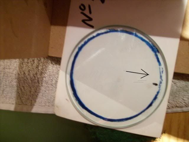

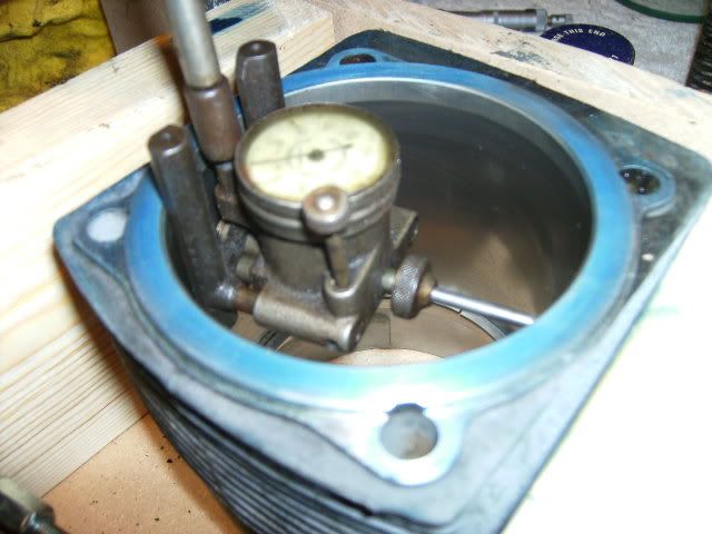

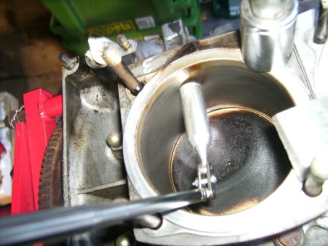

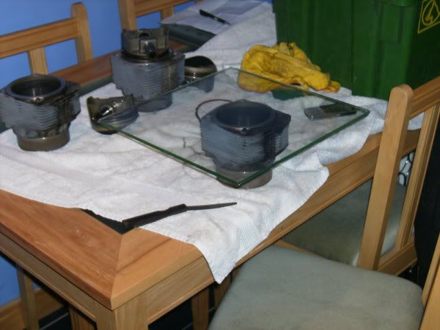

Checked the cyliderheads with plate glass inside the recess as an indication to the blow by.
No 6 and No 2 show wear at the exhaust side ( this explains the leaks i had) Strangely i had no broken studs, anyone experienced this before???

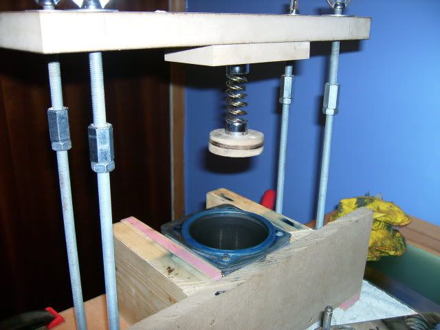

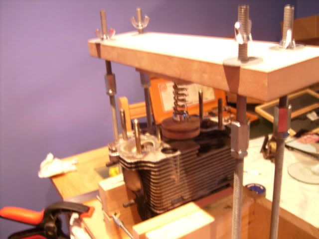

Lapping in the heads,
A small amount of lapping in sorted the heads out, did all six so made myself a little jig to give even pressure to each head.
Everything checked out to well within spec thankfully.

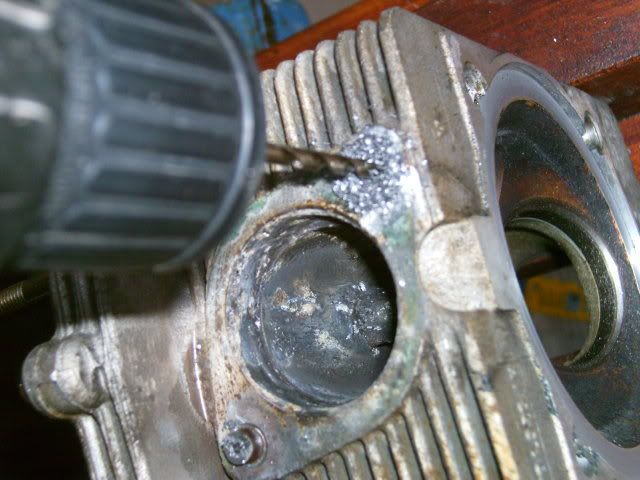

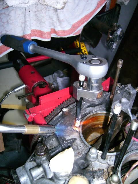

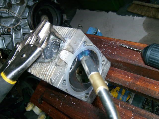

Tackled the exhaust studs this weekend, not to bad had to drill out three of them, purchased a couple of cobalt drill bits (good shout Ben)
Luckily all head studs came out pretty easily

Nice work :ani_clapping: The "little" jig for lapping the head/cylinders looks great. Did it take much heat to get the head studs to free off ? - will be tackling mine later this week...
Came out easier than i anticipated, keep the heat and tension on until they start to break free. The exhaust studs where the hardest ones, may yet have to helicoil a couple.
