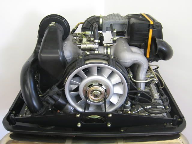

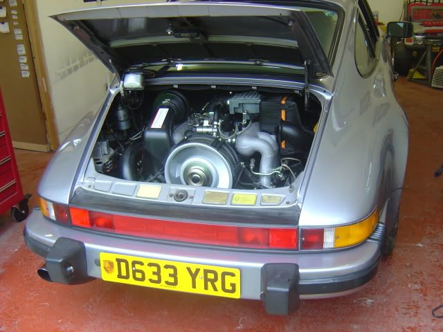

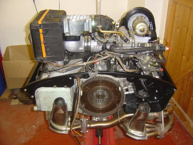

Any chance of a picture of the much neglected and little understood (by me at least) rear (or front I guess) of the engine?
No problem - here you go - rear tinware not fitted yet:

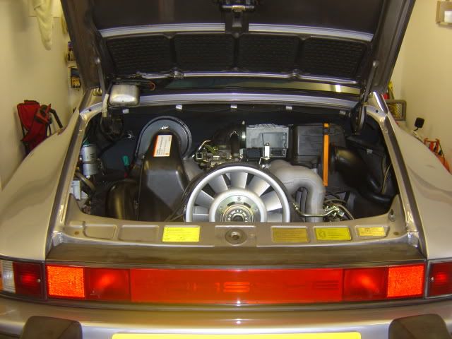

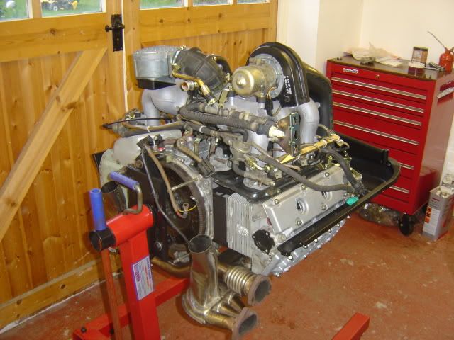

Time for another photo heavy update......

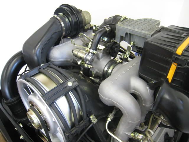

Engine finished with re-painted fan shroud so thought I'd take some proper pictures while its still clean !

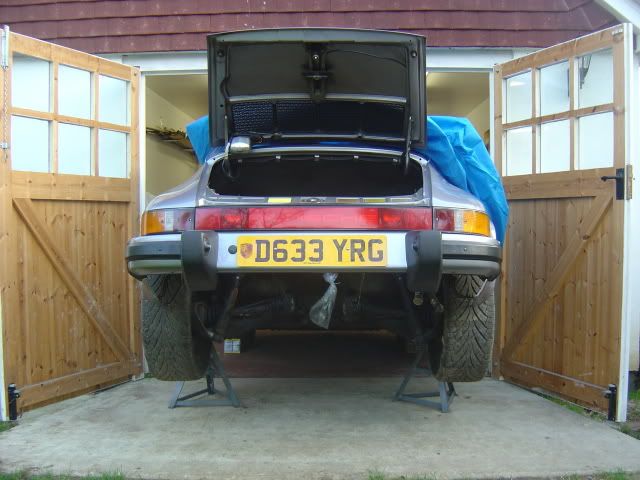

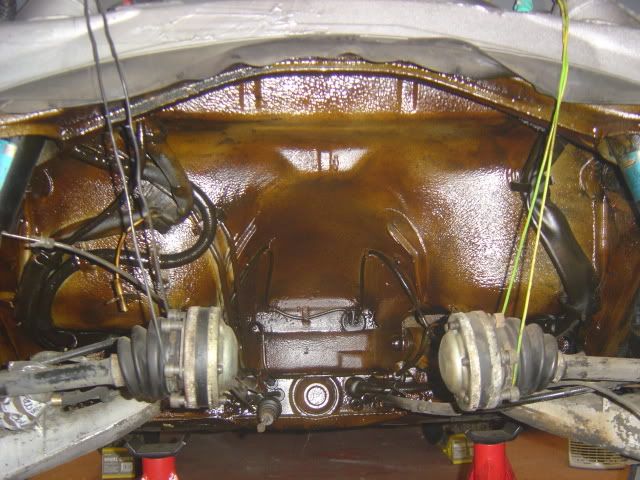

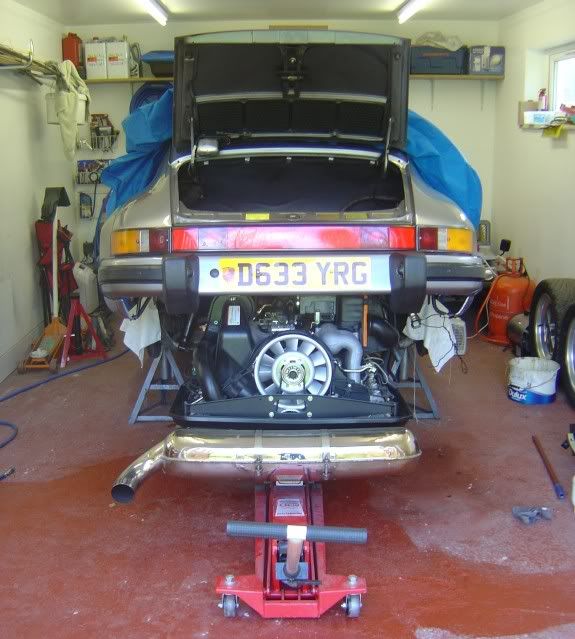

Started on the other bits, used the good weather last weekend to get the back end of the car out the garage and give the engine bay and rear bulkhead a degrease and pressure wash:
Much cleaner - just waiting for it to dry fully before applying the Wurth underbody wax

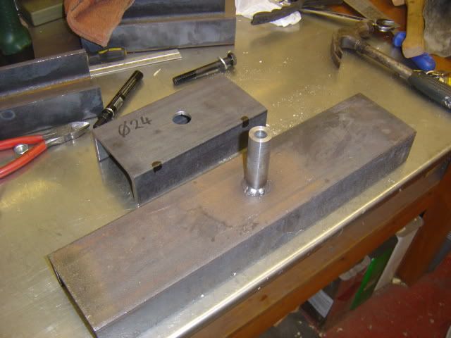

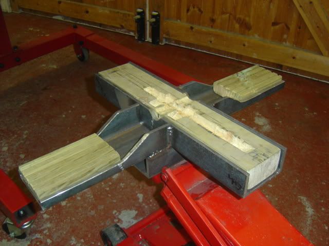

Started on another home made tool - work out what it is yet ?

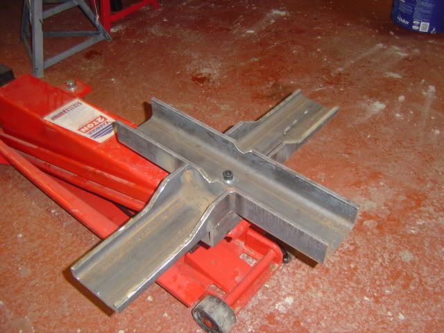

I didn't like how unstable the engine was on the jack so thought I'd make a proper jacking cradle. Used some 100 x 50mm steel channel probably a bit OTT but better safe than sorry ! Welded it all together tonight:
Bolts onto the jack so good and solid.
Made up some wooden blocks to protect the engine & H/E. Also means I can fit different blocks to work with different engines \ transmissions etc.

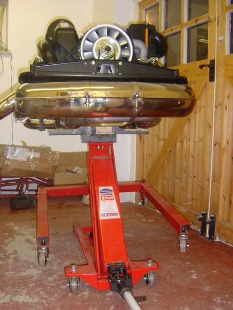

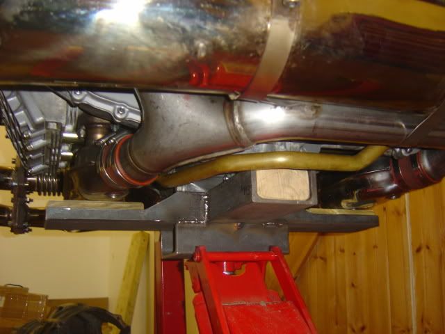

Load is taken along the crankcase centerline with the "wings" under the H/E to stop it tipping
Tried it out, worked well - lifted the engine (& engine stand !) no problem - very stable even when 4ft in the air :rolleyes:

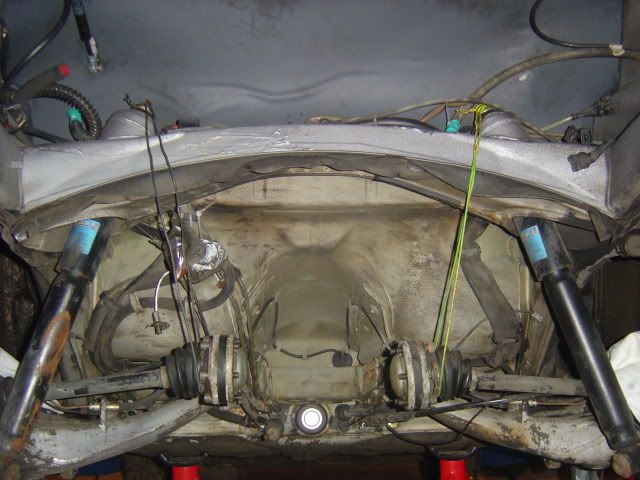

Getting there at last... treated the rear bulkhead with Wurth underbody coating, also got some cavity wax into the cross beam:

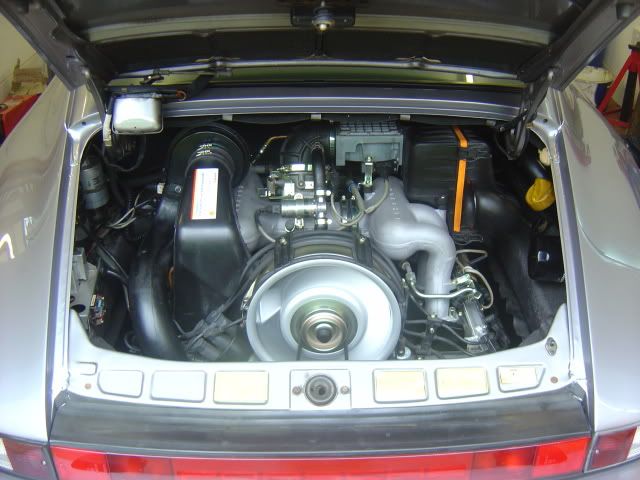

Got the engine off the stand and fitted the rear tinware and crank sensors, also new crank breather pipes (another speedy delivery from Tripe :ani_clapping: ):
Then spent a frustrating 2hrs+ fitting a new clutch slave cylinder because the clutch line nut was seized solid - judging by the colour of the brake fluid that came out I don't think it had been off (or bled !) since new.
Engine finally going in :
And in :rolleyes: - not all connected up yet but managed to get the clutch bled and throttle linkage sorted:
