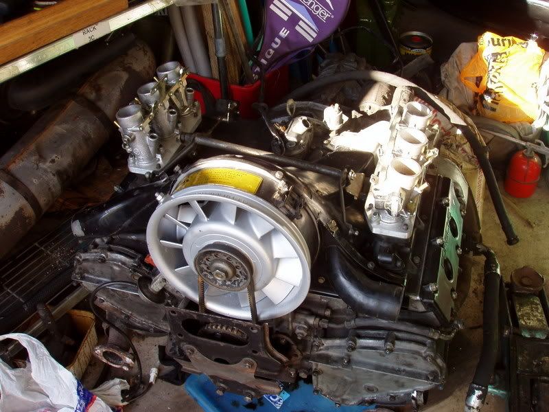

Must admit, this does look like fun tho:
This is the classic carbs look JG, using Triumph TB's :)
Go mate - is it back in the car yet?
