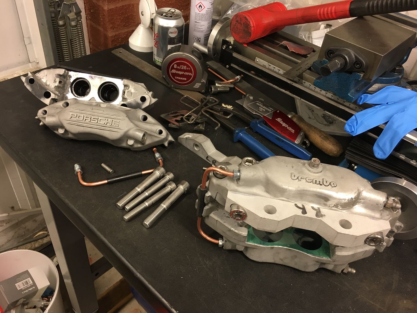

So, original non-servo brakes  were rubbish on track. Simple solution: buy a set of horrible condition 944 turbo calipers, strip, sand blast, replace seals, guide plates, hardware, bleed nipples and link pipes. Buy bench top milling machine, cut off original mounts and fabricate new ones. Clean up calliper throats to accept 930 rotors, buy new rotors including floating centres for the fronts. Replace all hard lines. Add Pagid Pads, race fluid and a proper pressure bleeder. Forget vent pipe in reservoir, clean up fluid and bleed system.
That represents more than a year of evening and weekend work. Cost double what i had expected and led to replacing wheels with 944 turbo Fuchs and the spare with a 996 16" one.991F0EB7-650C-49AC-9919-39720DE5A1CD_zps
Welcome back!
I know it's been a while but looks like it's coming along nicely. I love the brake project - I've had a set of 964/944T calipers sitting in my garage doing nothing for years hoping to do exactly the same as you so may tap you up for some dimensions and disc info.
Keep the updates coming.
Link to post
Thanks Alex. I have the drawings and dimensions written down somewhere.
